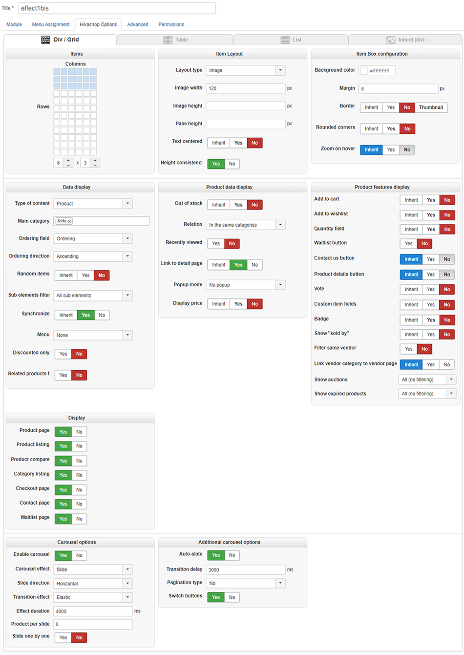

As with the first example, this carousel is moving automatically. To enable this functionality, just activate the "Auto-slide" parameter. You can also define the duration between two slides. The next option is really interesting. You can chose here how to display the carousel pagination. We selected here a thumbnail pagination, and put it on the right. As you can see, there is no dimension specified here, so the thumbnail size are 1/8 of the the product pictures. But you can specify a width and a height as in the first example. Note that when the auto-slide is enabled, the selected thumbnails are also changing.

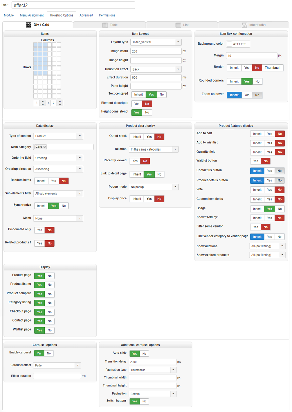

This carousel also have a special effect applied on the product. This effect come from the selected layout. Three animated layouts are available in Hikashop Business, vertical and horizontal slide, and a fade effect. When you select one of these layouts, some new options will be displayed allowing you to configure more precisely the effect. In that case, we selected the horizontal slide so it makes a slide between the product image and the product description. Note that the description displayed is the text typed before the "readmore" tag in the product description.

You can also see that the pagination is here "Name". With this pagination you will get the products name with the slide number before. Note that you can easily modify the CSS class of the product name to get something which match the design of your website. Here is the configuration page . :
The only option we didn't talk about is the "Slide one by one" option. With this option you can have the slider (this option only works with the slide effect) to slide one product at a time (so column by column or line by line if your table is multi-dimensional) or to slide page by page (so sliding 4 by 4 products if you have 4 products on a slide). You should now have all the keys to create your own carousel and display your products with some neat effects.
